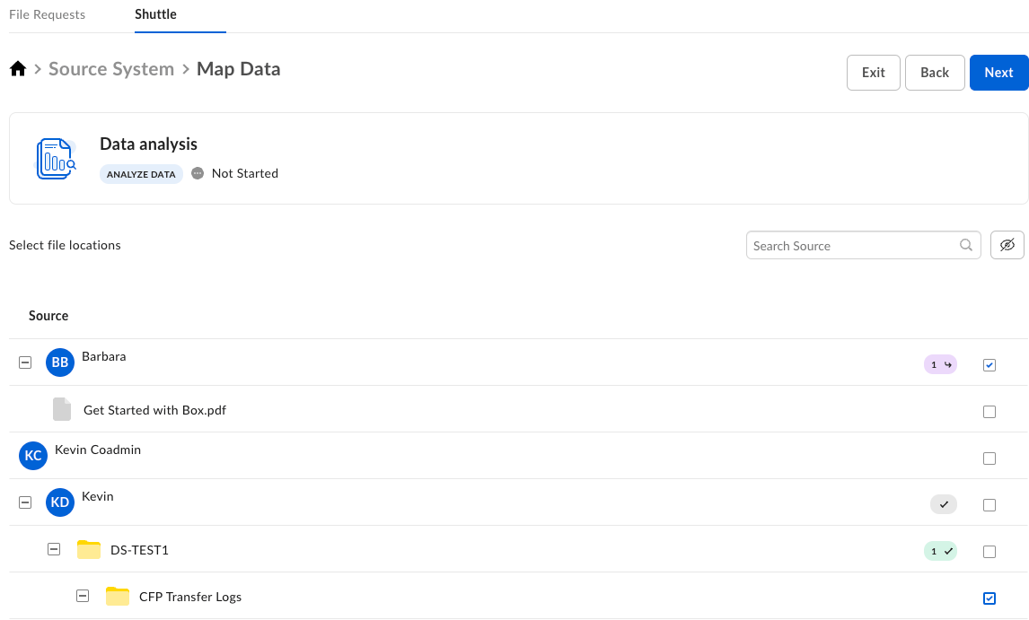

Select data
Select the data you want to analyze. Shuttle automatically lists the folders and files available for the chosen source system. Browse through the content or use the search field to look for a specific file or folder.
Box Shuttle Map Data screen with source folders Barbara and CFP Transfer Logs selected for analysis.
Icons on the right inform you about the content that will be analyzed.
ItemLevelDescription
Green status badge showing count 1 with a checkmark.
Folder, AccountAn item in the folder is explicitly included in the analysis. The folder itself will not be analyzed.
Purple badge with number 2 and a right-turn arrow indicating a mapping step.
FolderItems in the folder are skipped and won’t be analyzed.
Green checkmark in a circle indicating success or completion.
AccountCertain items in different folders in this account are selected for analysis.

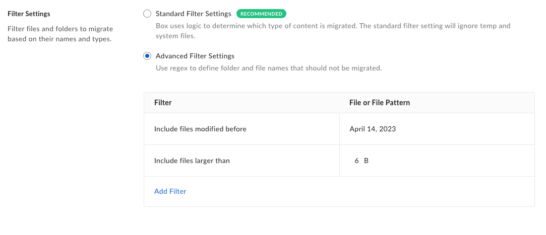

Filter data
Additional filters allow you to further narrow down the data.
  • Standard Filter ignores temp and system files, and migrates everything else. This is the recommended setting.
  • Advanced Filter provides more granular filter settings on the basis of regular expression, file extensions, date, or size.
Filter Settings with Advanced filters for files modified before April 14, 2023 and files larger than 6 B.

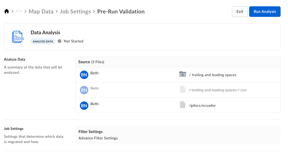

Verify data
During the pre-run validation you can see the summary showing the data you chose to analyze or skip, and the job settings. Verify if these are correct before proceeding with the analysis.
Pre-Run Validation for Data Analysis showing three source files and Advanced Filter Settings before running.
Run analysis
If everything is correct, click the Run Analysis button to start the process. When the analysis is running, use the Stop button to cancel the process or Exit to return to the Job Dashboard without canceling the analysis.

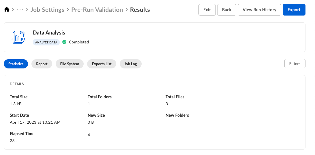

Check the results
You can view the results when the analysis is done, but also when it is still running - to check the progress. Access the results by clicking View Job Report. The Analysis report presents information about what kind of data there is, how old it is, how much you have and how it is distributed across users and filesystems, and who has access to that data. Analysis report details make it easier to divide a large complicated job into smaller more manageable jobs, and make informed decisions on what to move and what to leave behind. This allows big projects to finish more quickly, cost-effectively, with fewer conflicts, and allowing for more efficient delta runs.
The results of Analysis may differ from Migration simulation results for several reasons:
  • Analysis scans only the source. Migration simulation scans both the source and the target and runs a simulated job without moving live data.
  • Migration defaults to considering only the latest version of files, while Analysis includes all versions when applicable. That can inflate file counts and total size, making Analysis results larger than Migration simulation results.
The Filters button on the right activates a side panel you can use to display specific results.
Data Analysis Statistics tab showing completed job with 1.3 kB total size, 1 folder, and 3 files.
This section also allows you to check the Run History for data from the previous runs and export the data.

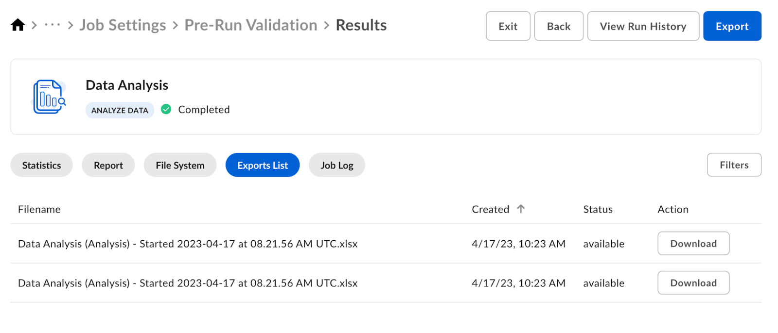

Export data
You can export your data in the XLS format. In the Export dialog, select the data you want to include in the report and confirm. When the download is complete, you can save the results as an .xlsx file.
Export dialog for Data Analysis job with report page checkboxes selected and Export Users set to migrated users.
Additionally, you can find all the exported reports under the Exports List and download them from there.
Data Analysis Results Exports List tab showing available XLSX reports with Download buttons.
