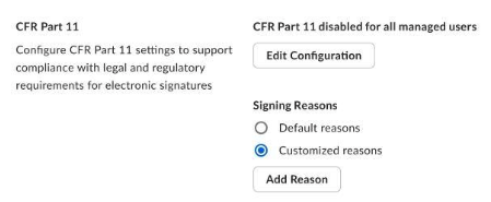

Signing reasons
Admins can customize signing reasons, but should ensure the customized reasons they include meet the 21 CFR Part 11 requirements. To Customize Reasons: Within the Admin Console, select Enterprise Settings. In the Box Sign tab, within the CFR Part 11 settings, determine if you want signers to either:
  • Select from a list of default or pre-defined signing reasons; or
  • Select from a list of customized signing reasons as set out by the Admins
Additionally, Admins can determine whether they want to enable signers with the option of providing their own custom signing reason when adopting their signature or initials to a signature request. Admins can configure their own customized signing reasons for signers by selecting Customized Reasons and then clicking Add Reason.
CFR Part 11 configuration panel with Customized reasons selected and an Add Reason button available.
The following restrictions apply when creating customized signing reasons:
  • Admins are required to add a minimum of 2 reasons
  • Admins can add up to 25 reasons
  • Each entry can only be 60 characters long
  • The default signing reasons cannot be changed

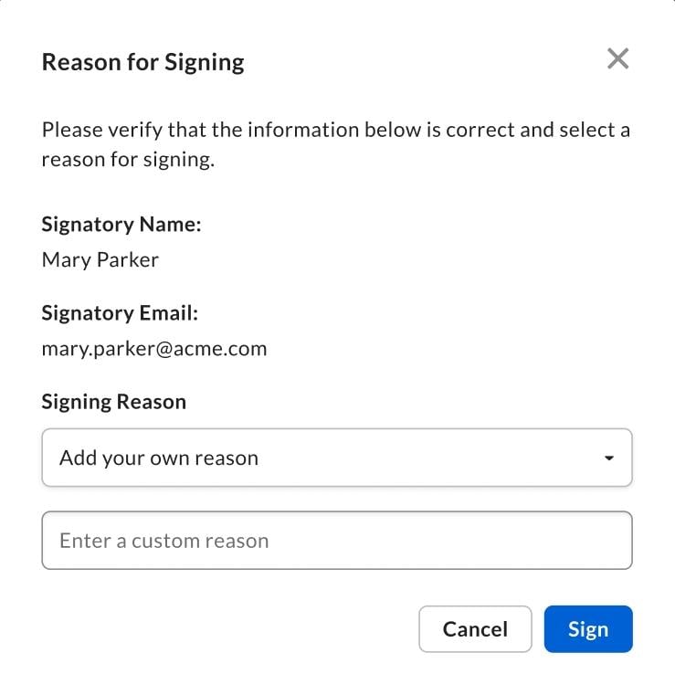

Reason for signing
After the recipient selects their signature or initials, the recipient can select the following reasons in order to proceed:
  • Default signing reasons, which include:
    • I read and approve this document
    • I read and agree to this document
    • I read and authored this document
  • A custom signing reason configured by the Admin or Co-Admin
    • Important: this option is only available if the Admin or Co-Admin have enabled custom reasons for recipients
Reason for Signing dialog for Mary Parker with Signing Reason set to Add your own reason and Sign and Cancel buttons.

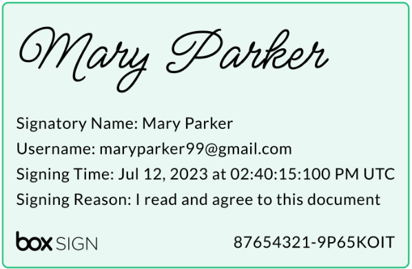

The recipient’s selection is recorded in their signature block or initials field within the signed document and in the signing log for reference.
Box Sign certificate panel showing a cursive signature, signatory name, email, signing time, reason, and document ID.

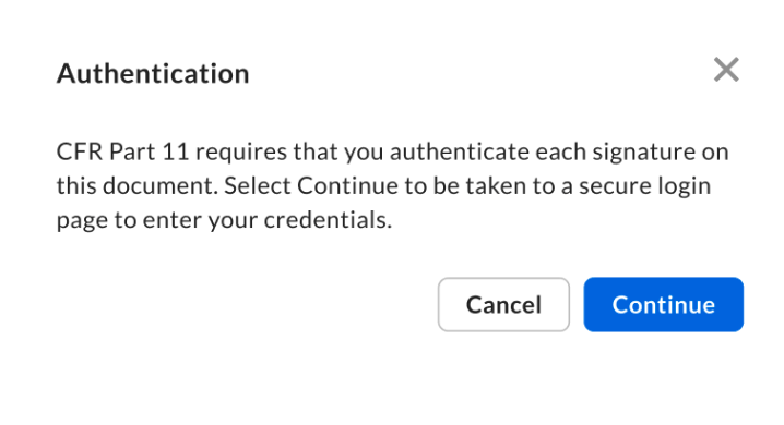

Re-authenticating each Part 11 e-signature
The Part 11 e-signature workflow will log you out of any open Box account browser-based sessions and reinitiate your account session by logging you back in at the time of signing. Be sure to save your existing work before initiating a Part 11 e-signature workflow.
After adopting your signature or initials or both, providing your reason for signing, and navigating to the next page, you will then be prompted to re-authenticate your session by logging in with your credentials. Re-authentication completes the signing process for that Part 11 e-signature. Recipients can continue adding their signature or initials to other locations within the request by clicking the next signature or initials field, selecting their reason, and re-authenticating their session. This process is repeated until all required signature or initials or both fields in the CFR Part 11 e-signature request are completed.
Authentication modal explaining that CFR Part 11 requires reauthentication before signing, with Cancel and Continue buttons.

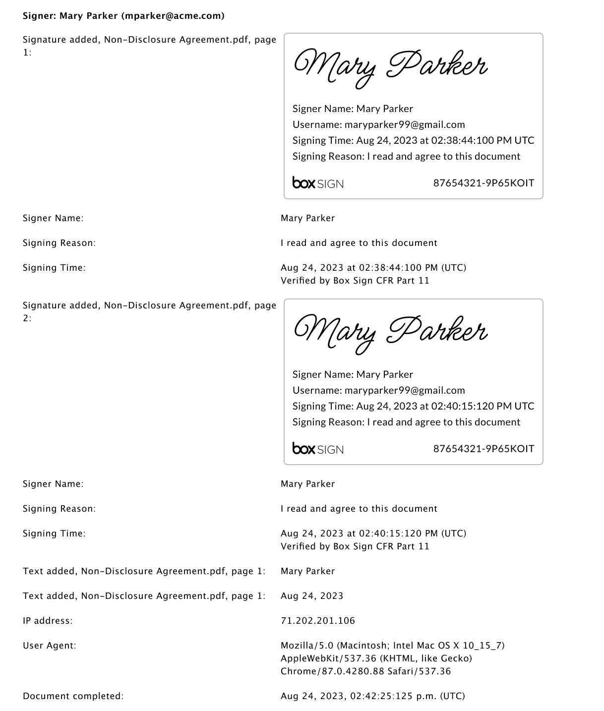

Signing log
Once the Part 11 e-signature request is complete, the Signing Log is available for review and reference. The signing log displays each Part 11 e-signature or initials or both, authentication details, and the signing reason as pictured below. You can learn how to access the Signing Log associated with your document here.
Box Sign signing log for Mary Parker showing CFR Part 11 verified signatures, signing reasons, and audit details.
